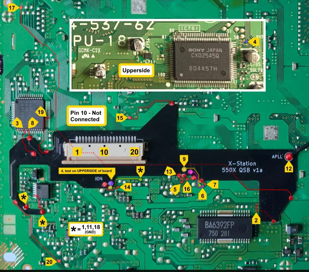

Hello,
I just wanted to report an issue with the early PU-8 version (CDX1199)—it might be useful, or maybe not.
I couldn't get the PicoStation working on this console version, which got me wondering!
I thought I might have made an installation error.
Unfortunately, that wasn't the case... after several checks, I didn't find anything unusual, and I even compared it with a later PU-8 revision...
I suspect a specific point on the "early" QSB is incorrect...
I modified that point on the QSB like this:
318272-0
Since then, my PicoStation works better... it finally boots up!
But...
With firmware versions RC3/RC5, the PicoStation stops working intermittently (a lot of freezes, crashes, etc.).
Version RC2 works much better... it still glitches very occasionally, but it's a vast improvement.
Has anyone else encountered this problem on the early PU-8?
Thanks.
Please do not post an image with a side larger than 700 pixels using the img tag. ghostdog3
« Последнее редактирование: 10 Августа 2026, 15:12:46 от ghostdog3 »

K@ss,
Ты взял фото установки qsb из инструкции к x-station и там точно нет ошибки,если китайцы правильно скопировали плату qsb.
Но ты точно сделал ошибку,когда использовал  подключение через qsb и гибкий шлейф на pu7 (ранней pu8).
Припаяй всё обратно,согласно схеме,перепроверь и попробуй подключить очень коротким шлейфом. Не длиннее 10см.  а лучше ещё короче
Фото твоей установки ?

I haven't found any mistakes at the moment and I used a much shorter flexible tablecloth of about 10cm as advised.
Unfortunately, I still don't have a result.
maybe my card has a problem because on my Pu-8 later and my PU-18, this picostation works very well...
I don't really know what's going on...
it displays the PS logo well then stops before displaying the picostation menu or randomly freezes when I manage to get the menu.
Sometimes I can run a game and then stops working (the game freezes).
I was thinking of a RAM memory but it worked with the optical block...
:neznayu: I don't know,
I'll try to find another PU-8 early to compare.

Доброго времени суток уважаемые форумчане. Намедни модифицировал SCPH-5502 китайской пикой с озона, с платой для быстрой пайки и платкой с самой пикой и слотом под флешку. В чем суть, проверка доступности CD приводы проходит, меню приставки с картами памяти и прослушиванием CD аудио грузится без проблем. Но меню пики ни в какую, какие только прошивки для пики и юниром для sd карты не использовал, ни в какую либо просто меню приставки грузит, либо пишет что вставьте оригинальный диск и нажмите резет. Помогите плиз для теста нужны заведомо рабочие прошивка на пику и юниромы для флешки. И в какой файловой системе должна быть флешка, размер кластера?
Оффлайн Gameszzz
  • Сообщений: 4526
Picostation PS1
« Ответ #3910 : 11 Августа 2026, 11:19:23 »
LordGellert,
Фотографии вашей установки ?
Оффлайн LordGellert

Оффлайн Gameszzz
  • Сообщений: 4526
Picostation PS1
« Ответ #3912 : 11 Августа 2026, 11:41:00 »
LordGellert,
Припой в точках пайки qsb выглядит сухим и вполне может иметь непропай в сквозных отверстиях. Так же следует проверить замыкание всех точек пайки ни минус и на соседнюю точку пайки у слишком близко расположеных точек пайки
Оффлайн LordGellert

« Ответ #3913 : 11 Августа 2026, 11:43:44 »
LordGellert,
А есть схема прозвона?
как то так
318308-0
« Последнее редактирование: 11 Августа 2026, 16:25:46 от ghostdog3 »
Оффлайн LordGellert
  • Сообщений: 14
Re: Picostation PS1
« Ответ #3915 : 11 Августа 2026, 11:52:57 »
как то так
Благодарю. Но не вполне понял на что замыкать точки помеченные звездочкой.
Оффлайн woddy
  • Сообщений: 205
Picostation PS1
« Ответ #3916 : 11 Августа 2026, 11:57:27 »
точки отмеченные звездочкой это земля / GND. земли на плате очень много. удобно использовать большой голый квадрат справа над QSB, там где провод APLL припаян, только выше
Оффлайн LordGellert
  • Сообщений: 14
Picostation PS1
« Ответ #3917 : 11 Августа 2026, 12:06:42 »
Замыканий по рядом находящимся точкам в режиме прозвона не обнаружено. Не звониться 14 линия. Пойду паять.
Еще вопрос а есть подобная схема, для платы с пико?
Именно такой не видел,но если взять схему пайки из первого закреплённого сообщения ?
Оффлайн LordGellert
  • Сообщений: 14
Re: Picostation PS1
« Ответ #3919 : 11 Августа 2026, 12:51:51 »
Огромное спасибо. после двойной пропайки 14го поинта и прозвонки всех линий из закрепленного поста от пики до платы и флешки, меню пики стартануло. Но вопрос с софтом висит, подскажите какой лучше брать, как  на прошивку так и на юниромы.

RC5 от Megavolt85. В архиве версия для PU18 (та что не OverClock)
Закидываешь образы игорей в .bin/.cue на кп (можно в папках) и пользуешь
